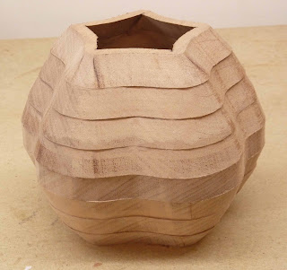

Inspiration scroll saw bowls
http://scrollsawbowls.blogspot.com/2013_03_01_archive.html
